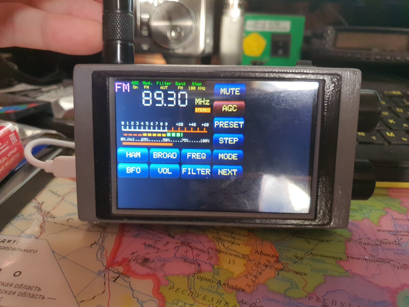

Эта прошивка зашилась сразу, но под другой экран)IU4ALH писал(а): ↑24 авг 2022, 15:21Hi guys !!

- Сообщения: 51
- Благодарил (а): 48 раз
- Поблагодарили: 29 раз
Сообщение IU4ALH » 25 авг 2022, 14:49
Hi RA3IAI ... this you took from my Github and put on your 4 inch screen, is my version for the 2.8 inch screen taken from Gert PE0MGB, and I named it "FullRds_V. 5.0b" .... it is not for 4 inches !!!!..... You have to download this file from my Github >>>>... "Vers5.2b_for_4_inch.zip" and you will see that it works great !!!
Let me know, bye
IU4ALH
- Сообщения: 158
- Позывной: RA3IAI
- Город: Тверь
- Имя: Алексей
- Благодарил (а): 74 раза
- Поблагодарили: 52 раза
Сообщение RA3IAI » 25 авг 2022, 15:21
Good afternoon! I got everything mixed up as usual)) I'm just experimenting, I'll try another firmware too) Thanks for the work!))IU4ALH писал(а): ↑25 авг 2022, 14:49Hi RA3IAI ... this you took from my Github and put on your 4 inch screen, is my version for the 2.8 inch screen taken from Gert PE0MGB, and I named it "FullRds_V. 5.0b" .... it is not for 4 inches !!!!..... You have to download this file from my Github >>>>... "Vers5.2b_for_4_inch.zip" and you will see that it works great !!!
Let me know, bye
RA3IAI

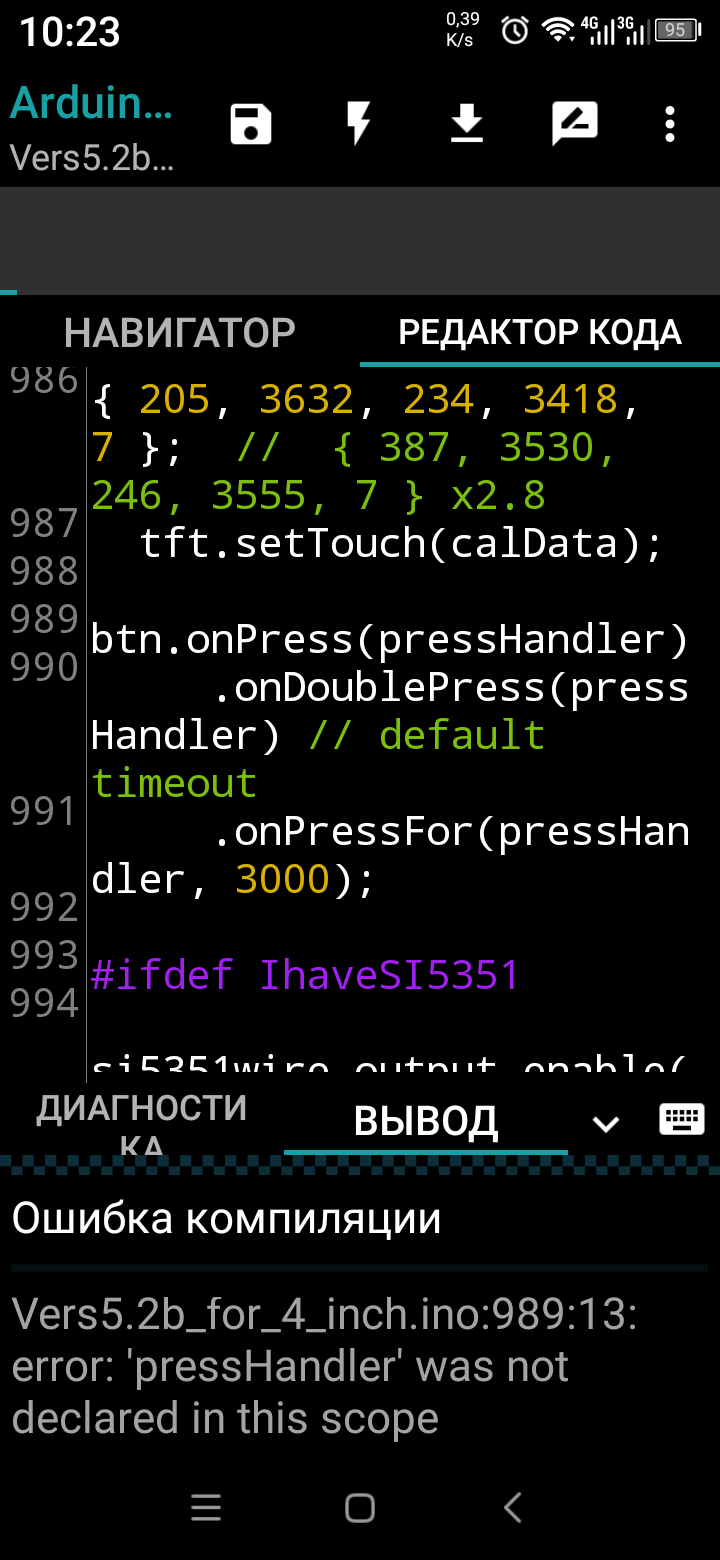

Сообщение Step2 » 27 авг 2022, 12:34
Vers5.2b_for_4_inch.ino:989:13: error: 'pressHandler' was not declared in this scope !!! Помогите что не так?

Сообщение IU4ALH » 27 авг 2022, 14:19
Did you use my TFT_eSPI library for the 4 inch ???
Find it on my GitHub. and you have to replace it with the one you find in the folder ..... users / documents / Arduino / libraires ... check that you don't have any other ones also in the Arduino / libraires installation folder ..., if there are, remove them and set them aside.
