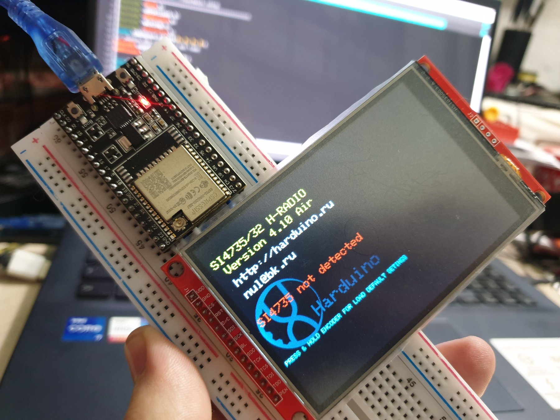

Быстренько собрал ESP со своим экраном, заменил папку TFT_eSPI на ту что в архиве TFT_eSPI_for4inch.rar от Antonino IU4ALH и все заработало

Hi Guys ... I'm glad you are considering 4.0 inch screens ..!
a small clarification to what rightly said by "open Minded" ... the TFT_eSPI library to work with ili9488 needs some changes ... not only on the "User_Setup_Select.h" file, but also on other files that are an integral part of the library itself ... in practice you have to remove the // from all the lines concerning ILI9488..you can easily compare them and you will notice.
For this reason, and to save you all work, I put the compressed file on my Github containing a TFT_eSPI for 2.4 / 2.8 / 3.2 inches and another compressed file TFT_eSPI for 3.5 and 4.0 inches, to totally replace the library already present in the Arduino folder. libraires and ..... it works !!
Greetings to all of you.
