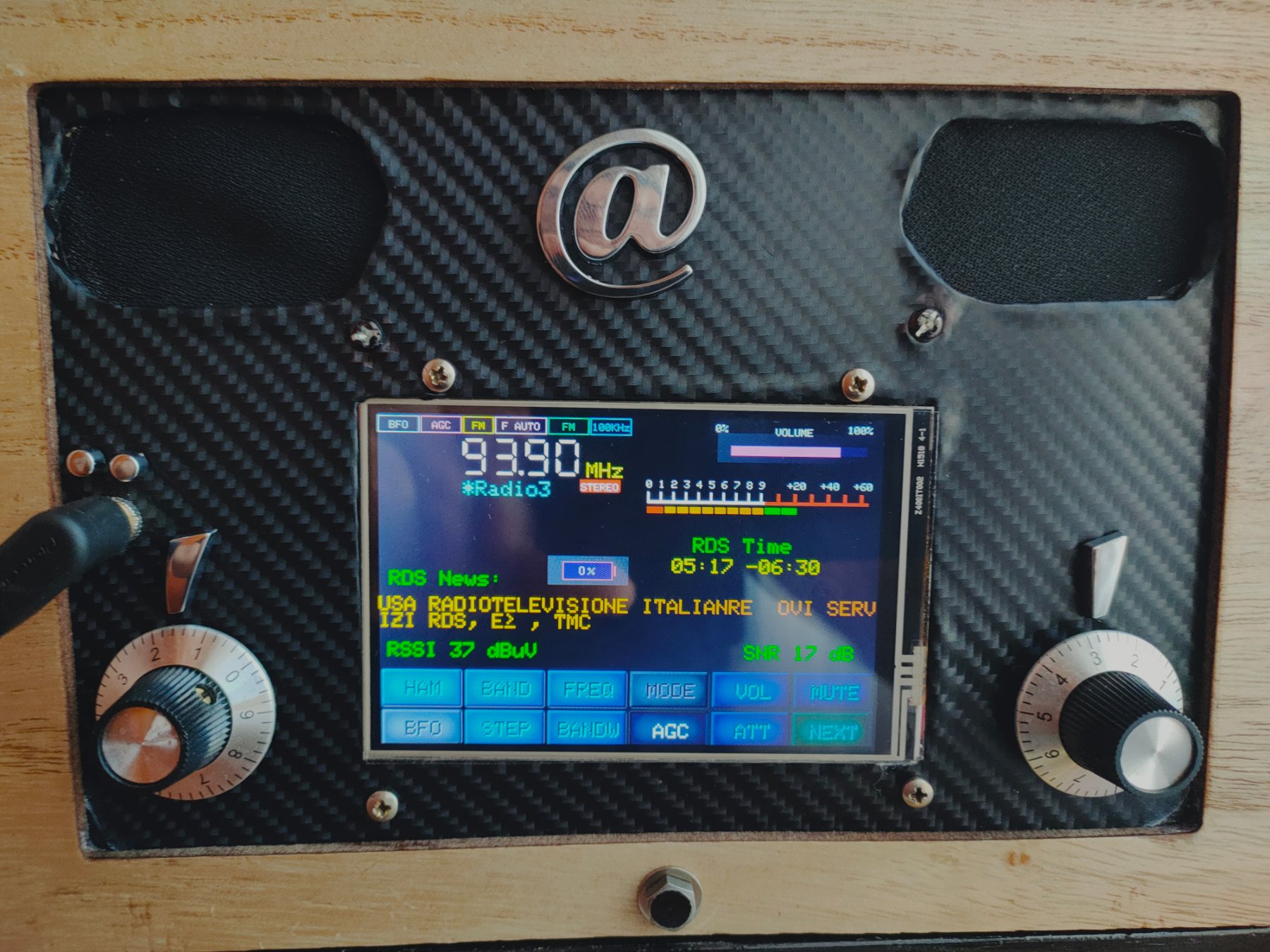

Hi everyone ... I want to post this photo that portrays my latest homemade receiver with Si4735, ESP32 and 4-inch display (ili 9488 - TFT_eSPI) where I adapted, to that 4-inch display ( tks YO2LDK ), the Binns firmware 4.0 with addition ... always made by me ... of all the RDS services in FM (Vers.5.2a _for 4inch_calibr) ... this while waiting for dear Binns to release his eagerly awaited creature V.4.1 ..... !!
Obviously, Dr. Binns has promised to also make a firmware for displays that use displays with ILI9488 drivers (from 3.5 to 4.0 inches) ... so this release of mine is to be considered only an experimental test.
You will find the firmware on my Github ...
https://github.com/IU4ALH/IU4ALH/tree/main
