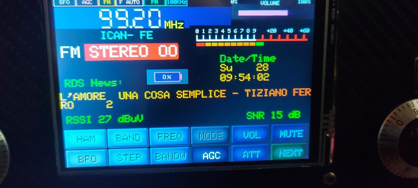

hi boys....
I put this post to inform you that on my GitHub I have uploaded two sketches ...
one for 2.4-2.8 inch screens
one for 3.5 - 4.0 inch screens ...
with implemented the date / time function directly obtained from the internet via your Wi-Fi (to be configured with name and password in the sketch before loading it on the receiver) .... this thanks to the work and commitment of our friend Emphi Erte who has made the change and of which I indicated in the introduction in the same sketch ... to your satisfaction ..

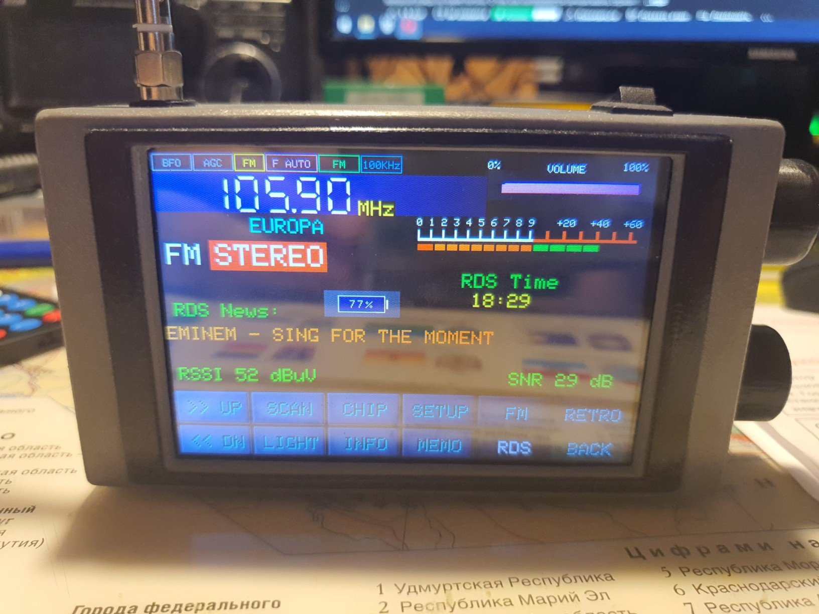

RA3IAI писал(а):
28 авг 2022, 18:25
Very well .... but now load the version with the WI-FI (if you have a wi-fi at home) ... it's improved ... let me know ..- bye

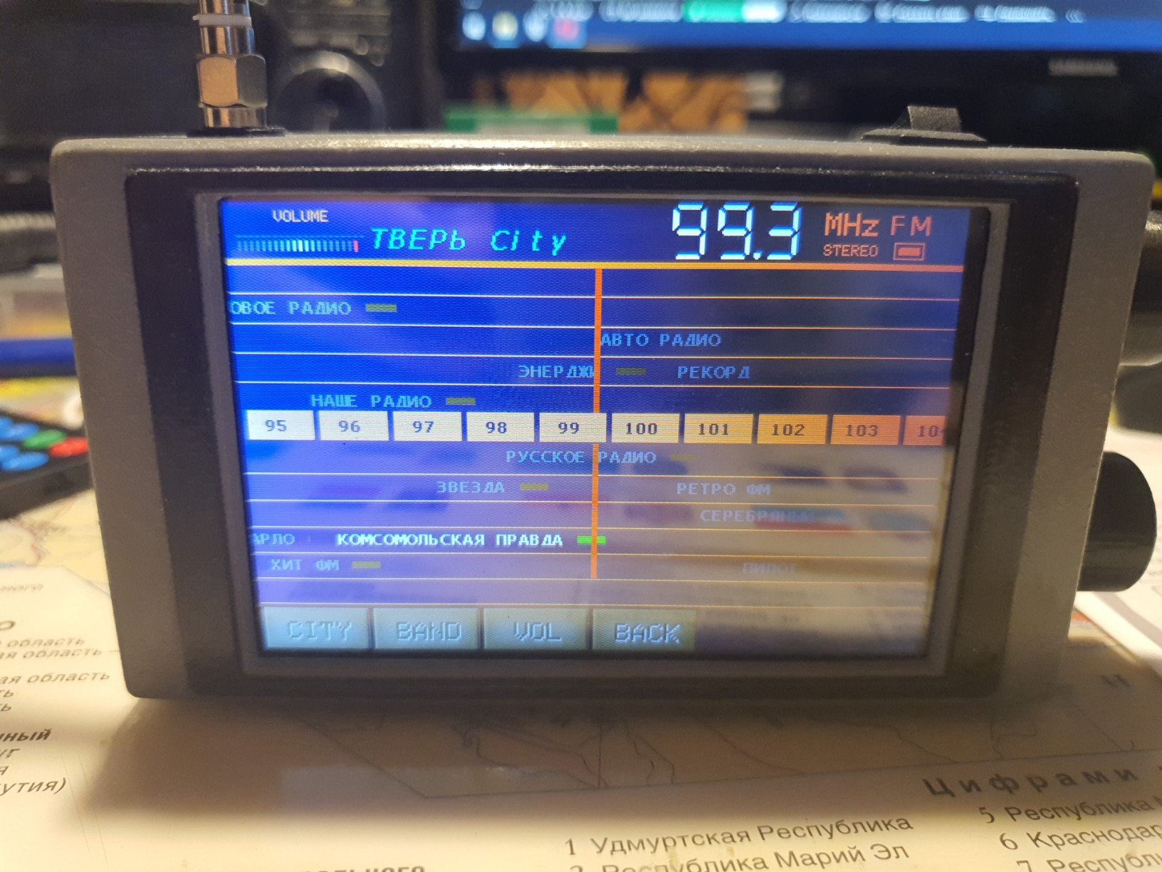

Good evening, IU4ALH! A friend is interested in how you can flip the image on the screen in this firmware?)
IU4ALH
Сообщения: 47
Благодарил (а): 43 раза
Поблагодарили: 23 раза
Сообщение IU4ALH » 30 авг 2022, 21:20
RA3IAI писал(а):
29 авг 2022, 19:21
Good evening, IU4ALH! A friend is interested in how you can flip the image on the screen in this firmware?)4af1b222-9dd2-40f5-a1f5-43ec84b2ffaa.jpg
Привет, Алекс..
Конечно... посмотрим, смогу ли я объяснить...
на линии нет. 110 эскиза поставить это значение-
#define SCREEN_H 3
на линии нет. 112 скетча вы должны заменить эти значения-
uint16_t calDataH [5] = {205, 3632, 234, 3418, 1};
на линии нет. 1011 эскиза поставить это значение-
tft.setRotation (3);
на линии нет. 1012 скетча вы должны заменить эти значения-
uint16_t calData [5] = {205, 3632, 234, 3418, 1};
конец..
Дай мне знать.. пока

Доброе утро! Мы попробуем, и напишем о результате) Спасибо!)

My friend could not turn the screen over, then the touchscreen does not work, then one screensaver turns over, he said he would wait for a newer firmware))
