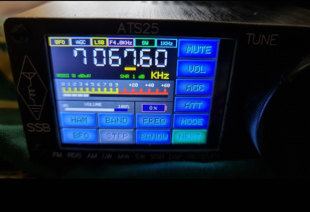

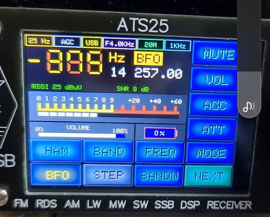

Сообщение Popatik » 26 апр 2022, 22:43
Hello Binns.
Thanks for your fantastic work.
I have a question, how can I remove the background of the numbers?
They are not seen correctly, do I have to modify any Firmware parameter?
In v3. 4 didn't have that problem.
Thank you.
Thank you.

Сообщение IU4ALH » 27 апр 2022, 14:37
Hi Popatik ... just set the function with this procedure: -
on the display press on NEXT - SETUP - Digit backlight (remove the white square) - EXIT - and SAVE ..
Done ! hi
Done ! hi

Сообщение IU4ALH » 27 апр 2022, 14:44
Hi Bernard ... I'm sorry if I do this, but I noticed that several users have problems displaying the frequency when the "Digit Backlight" function is activated.
This is definitely due to some brightness factors, but I have noticed that this varies from display to display ... on some it is fine, on others it is more difficult to view ....
Do you think it would be more useful to eliminate this function, leaving black (as the background) the segments of the unused digits?
hello from IU4ALH Antonino.

Сообщение Popatik » 27 апр 2022, 15:21
Thank you very much Bernard.
In my case it works perfectly by deactivating that function.
I know I repeat myself, but great job with the Firmware.

Сообщение Binns » 27 апр 2022, 22:29
IU4ALH, In version 4.1, this backlight is slightly dimmer. And it is also disabled in the settings.
